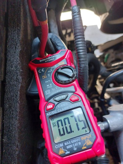

I like the Amprobe for testing for parasitic mystery current.
I bought one on sale at Amazon.ca for about $50.
It's one thing to suspect a mystery current, but much easier if you measure the current draw.
Open the hood, lock the truck and leave the FOB in the house. Wait 15 minutes, make sure the EVIC is still off, and start measuring the 12 VDC heavy gauge wires on the batteries for current draw.
Do you own a basic digital multimeter?
At least, you could take frequent measurements after a shutdown and monitor the B+ to be sure your truck doesn't have a parasitic current.

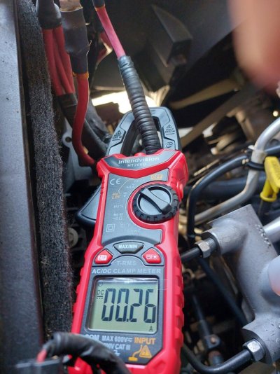

That was the only way back in the '70s & '80s, or the days before the Internet and Amazon, when a DC clamp meter was expensive.
These days, a DC clamp meter can be purchased online for less than $50.
As much as the thermal camera concept is attractive, I'm not convinced of the reliability of finding the culprit these days, when many of the electronics are buried.
The clamp meter will identify the current draw, and fuse pulling will find the circuit, PDQ.
