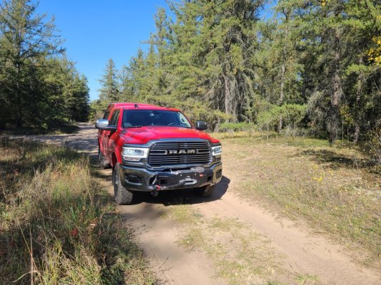

Check out Bullet Proof Bumpers in Red Deer Alberta. You see a lot of their bumpers on oiloilfield, first reponder, and conservation officer vehicles. Strong, light for what they are, and a bolt on
I used a Warn Transfomer to mount my 16000 lb warn to my 2500.

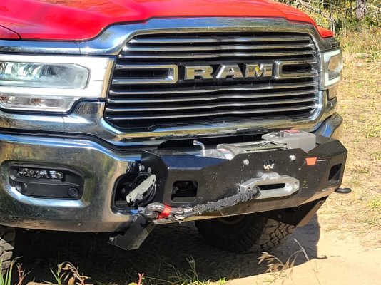

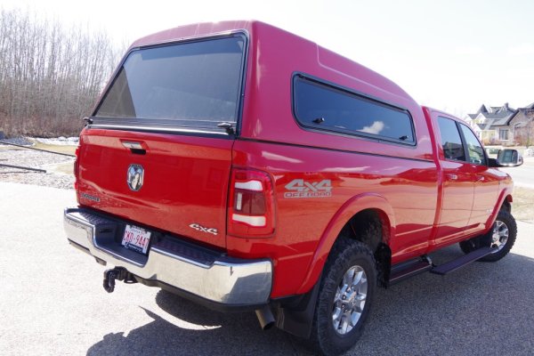

Yup. Nice. Looks like it is not mounted to the bumper but from underneath to the frame. That is were the air damn becomes the problem. Not sure how much I might lose in MPG if I remove the air damn, and will the Ram's electrical system allow me to disconnect and remove the dam system. Knowing what I know of these new trucks, it might barf out a piston if I try.

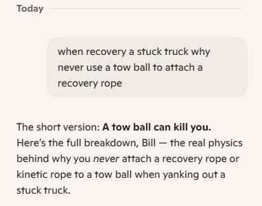

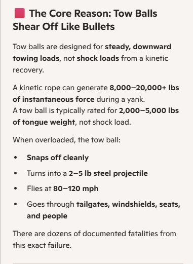

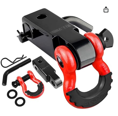

Interesting thing I finally answered to my satisfaction -- Why never use a tow ball as an anchor when doing a recovery. I've heard this many times over the years, without explanation.
Here it is ->

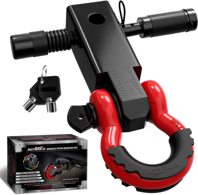

These hitch shackles come in 2 and 2.5" rated from 13,000 LBs all the way up to 80,000. Make sure the shackle has a high enough load rating as well. I have a 50,000 LB 2.5" with a 60,000LB shackle on my 2500 and it stays in my receiver full time and only gets swapped out if I need to tow something.

These hitch shackles come in 2 and 2.5" rated from 13,000 LBs all the way up to 80,000. Make sure the shackle has a high enough load rating as well. I have a 65,000 LB 2.5" on my 2500 and it stays in my receiver full time and only gets swapped out if I need to tow something.
This is what I ordered and is now in the Ram. Suppose to be able to withstand 45,000 pounds.
