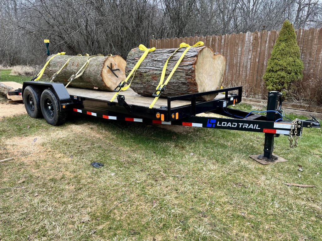

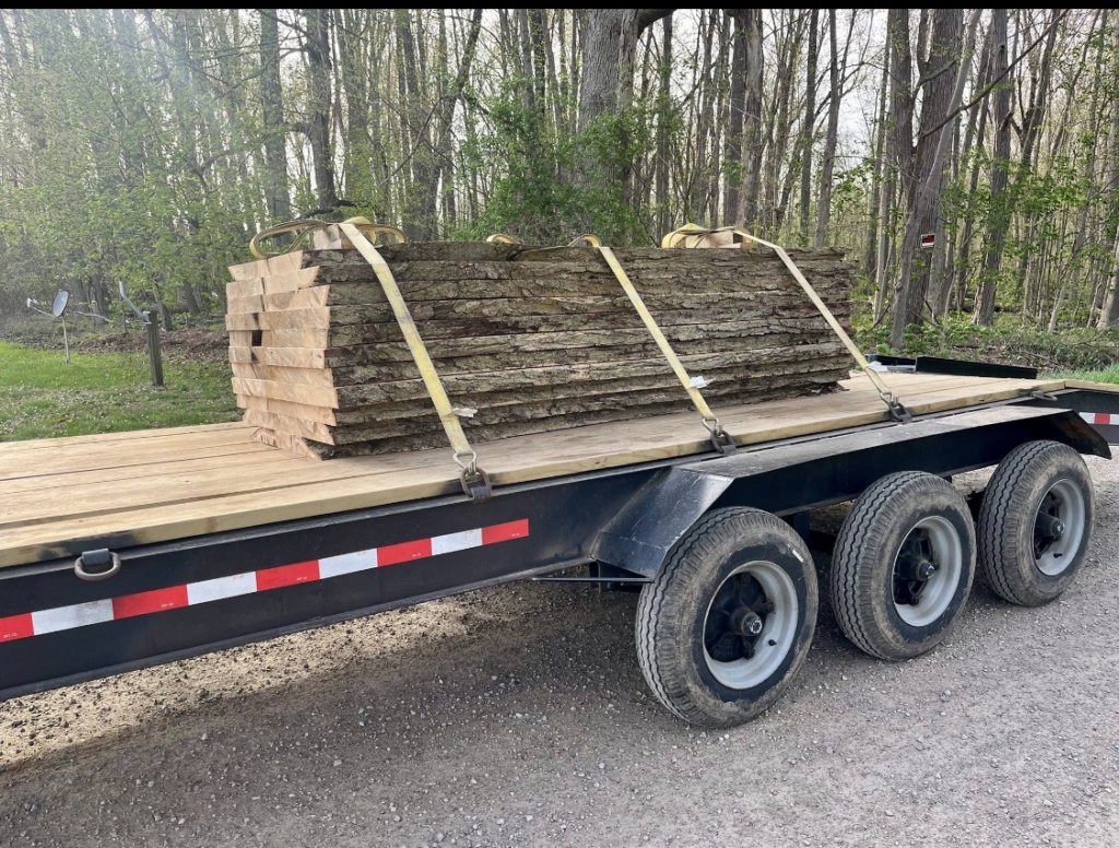

Here are a few pictures of how I do it when hauling my most frequent type of load. I simply roll the strap up in a big loop and slide it under the strap before fully tightening. Then sinch it down.
It has never failed me. But there are times that it’s difficult to find the appropriate spot (flat slabs) that will retain the roll. But as I said, it has never once failed me, but I don’t think this will work great for everyone.

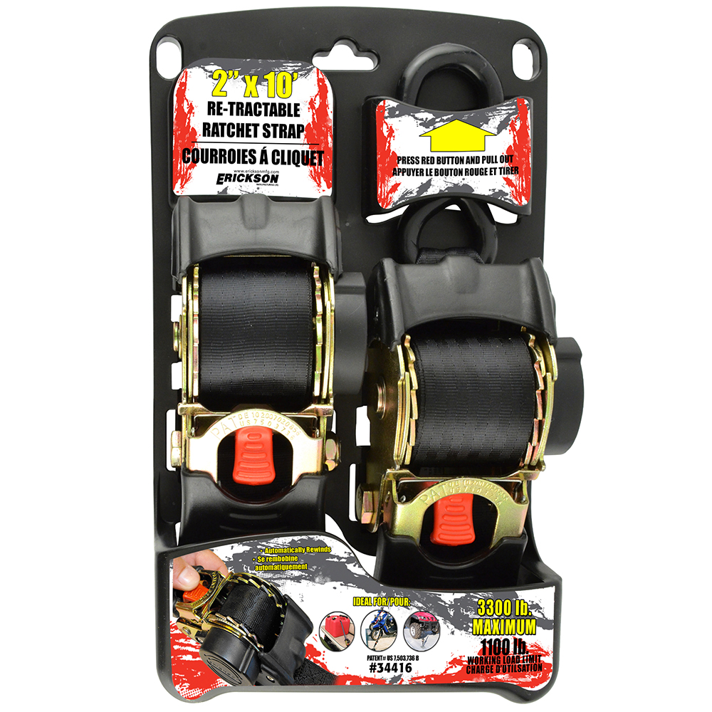

At a very minimum i need 3,000lbs working load. I dont see that they make them that
Erickson is not the only manufacturer, Mytee also has them, more commercial oriented. I have not seen any bigger so you're probably out of luck for that working load.

Personally if I have to use a strap it has to have a minimum of 10000 lb. Breaking Strength, I have seen the damage when people use the wrong or undersized breaking strength straps....

The 3,000 lbs working load straps have a 10,000 breaking.
i actually have 1 of the same straps (3,000 working 10,000 breaking) that the ratchet got damaged. So for years iv been using the strap from it to skid big logs . Works great.

Something is off, according to the limits printed at the above link (copy of photo below.) as I read it, it can't handle anything more than 3300 lbs max (I assume 3300 breaking) with an 1100 lb workload limit. I also should have written mine as a 10K workload not 10K breaking, my bad. Just read the specs on the strap"
Specifications​
3300 lb. Breaking Strength
1100 lb. Working Load Limit
