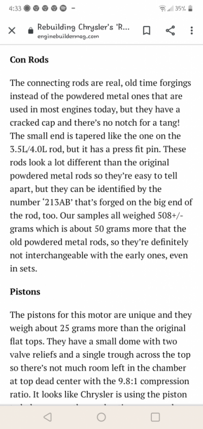

On a good note, Today amongst my daily 4.7 homework and knowledge gathering I stumbled onto www.EngineBuilder.Com and found an Awesome Article on rebuilding "Chryslers Revised Engines" and Saw a familiar driver side cylinder head pictured in the header of the article... An '08 Ram 4.7 head circling the egr valve for some reason...idk So reading on, it finally started talking about my beloved project engine and all the revisions.... I particularly liked the section on connecting rods as from all the wonderful readings ive found elsewhere on the net, I was under the assumption that I had the "lightened con rods and piston assembly of the powder metal variety.... And boy was I wrong... Being the quad cabs are considered a full size truck, Chrysler didn't install the lightened rotating assembly as I thought prior but used Traditional Forged rods instead of PMR's... I am super pumped!!
Another good read i found was @ www.Allpar.com which covered the 08 revisions and also backed up the statement of the Ram trucks getting the 36MnVS4 forged steel rods... But todays find sealed the deal... Being I currently know I dont have the powder metal rods, but the Real Deal rods which already have the new .50 over 9.8:1 pistons hung... Ill be sending them torqued to the machine shop and have the big ends checked for taper and wear, and judging from the minimal if any wear that was on the bearings, I could be putting the new rings on within a week or so... For now, its been a good day, got to hang out with the kiddos, learn about having forged rods, and now time to go cut the grass...Enjoy
