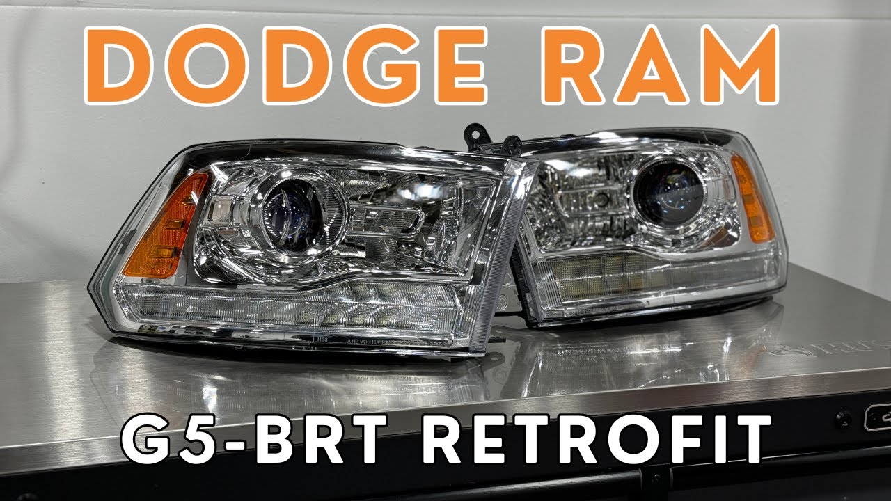

The OEM projector is still a halogen based projector and it's optically optimized for halogen. A quality hid bulb optimizes it's center to mimic a halogen, that's why they work well in halogen projectors. HID bulbs do drop off in output and color over time, so it's recommended to replace them every so often. They might not burn out, but there will be a significant difference in output over a very old bulb. Especially if you upgrade to one of the better osram his bulbs available. The best bang in terms of ballasts are the hylux ballasts, and from what I've seen, you're better off sticking to 35 watt to prevent burning the projectors up.
Led bulbs in halogen or hid projectors don't work near as well as a quality hid. But, an led projector optimized for an LED board is approaching hid output. Lightwerkz on YouTube has some really good videos showing the before and after on a ram setup.
