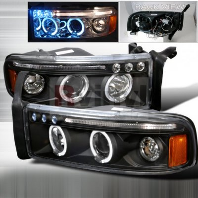

BlackMagnum had the same problem with his. He has a thread on it if you do some searching. Either this section or the audio/electric. Also your halos wouldn't happen to be these would they?
These are SpecDTuning headlights light bassslayer mentioned. Lots of places on eBay sell them too. Problem is only the ones directly from SpecDTuning work properly and even then they absolutely don't look like the pics. Ask me how I know. I really don't know anybody that would recommend them to anybody, at least not with halogens. BlackMagnums do well but he has an HID kit.
If these are in fact the headlights you bought, check how many resistors there are on the back. IIRC there should be 3 or 4.

I got the spec ds myself and tho I liked the look, with all the night driving I do it was dangerous with their light output. I got sick type housings from ebay without extra accessories to em and I pot a 9004 LED conversion kit in and I couldn't be happier
2000.2500.ram
Feb 19, 2015
69
2000
12v cummins
them are it. But chrome. But later down the line. (Couple months) I'm gna break them down and install color morphs in them so it'll be all fixed and do some other things. But I figured out what it was. The on the halos there's a adapter on that connects to the headlights. Which JM guessing runs the low beams and high beams. If u unplug it they go off. So theres a wore running from the adapter some where into the halo.
