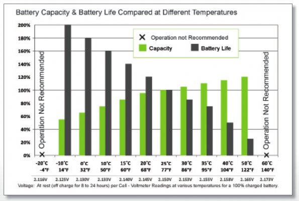

In cold places the capacity goes down eventhough the battery life extends. A lot of guys will run larger capacity batteries like h8 instead of h7. In theory it will extend the interval when you need to change the battery out. You need capacity for those cold crank amps.
