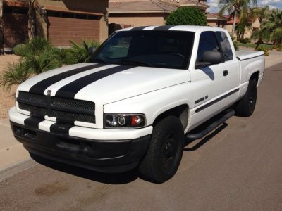

Fairly easy just get your measurements right so they are how you want them and clean with rubbing alcohol then get spraying. Work in sections too because you need to peel the tape while the dip is still wet

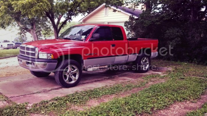

1999 Ram 1500
5.9 Magnum 360

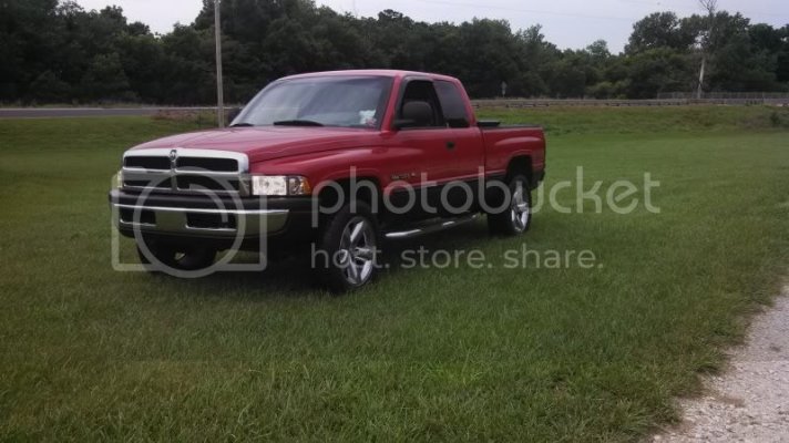

I haven't done the the stripes but I have two toned mine with it. Like said before work in sections. You have to be quick with pulling the tape. I learned that after you pull the tape if you dont like the line you had. You can backmask. Basicly putting the tape on the plastidip and use rubbing alcohol to make your straight line.
Before
after
