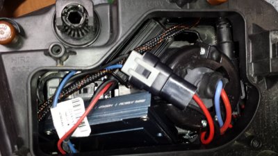

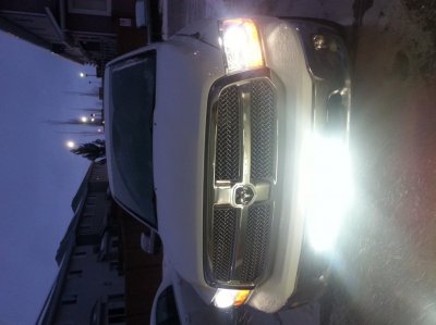

well got them in there..holy crap its tight. not very happy with how stuffed it is in there.
right side seems to flicker a lil bit when i turn them on. i had a problem with the clips that go from hid bulb had too remove 2 of them and just use silicone to make it watertight.
ill never do this again thats for sure.im sure down the road im going to have issues inside the projectors.
got my fogs in too.
got my fogs in too.
Thank you for posting the pic.
I am just about to do the same.
honestly i wouldnt..if i were to do it again id mount the ballast outside.
im even thinking of taken all apart again and doing that.
from what i can see the new ballast are longer.
just take your time the dust cover will never sit flush just dont tighen the bolts to much.

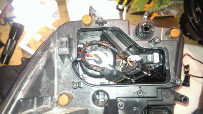

Here is my 35w 5000k hid from Jeremy.
ignore the light bar in the center lol

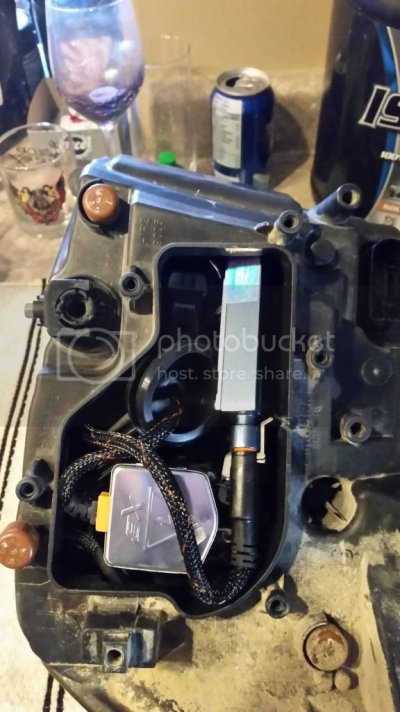

I have the new XB 55w Ballasts and Canbus in my headlights. It took a bit of Tetris, but I was able to do it.

I have the kit contains:
2 x HID 35W bulbs
2 x 50W ballasts
2 x AMP connectors
2 x canbus adoptors
I was able to put them all in but I removed the bulb retaining ring, put all in, then reinstalled the ring.
I still have to so the driver side.
So far, I managed to break the passenger side lower grille retainer clip. I have to come up with something.

holy crap.........thats a tight friggin fit.
