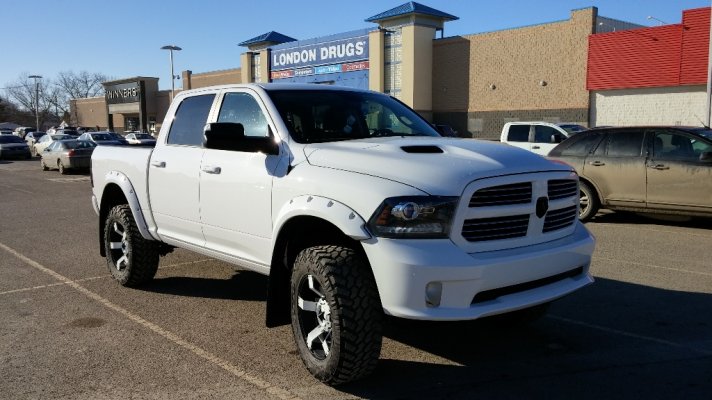

Hey, so I have a 2013 Ram 1500, I got it lifted last year with a 6" RCX and 295/65R20 Trail Grapplers.
I just got the summer tires put back on this year and I'm thinking I want to go higher. What's the best way to fit 37s under the truck without having to trim anything? Bilsteins? 3" body lift? Do I need anything more for the rear?
Also I only have 3.55s on the truck and really don't want to regear (I also pull a camper) is it worth it for me to go bigger or should I shatter this dream? (At this point mpg don't matter)

What does your camper weigh? With 3.55's you won't be towing much with 37's... You gotta remember that towing capacity is greatly reduced when going to a larger, heavier tire without regearing.
As far as fitment goes, what are your rim specs? That plays into fitment just as much as lift height does. If your stance is narrow you can fit 37's on a standard 6" lift. With a wide stance you can't.... So we need a little more info here before we can give you any solid answers.

As far as tires go I wouldn't be going to an aggressive mud grappler, I'll stick with something lighter. And if I can stay in that 12.5 wide range would be great too.
My camper weighs around 4300 lbs dry I believe. So not too heavy but it's up there.
And my current rim are 20x9 I believe. Thing is to I don't really like the stuffed look so I'd like to be able to clear the 37s with lots of room and not "just" clear.
Also gears are really low on the list seeing as I have the 13 ram, so changing all that out with a new front diff and everything will set me back close to 3 or 4 grand.

So you're probably around 5500 lbs or so loaded. Do you have the 8 speed tranny? That will definitely help you out. If that is the case you definitely can get away with 37's... you're just going to feel the truck being a lot more sluggish when towing.
What's the offset of your wheels? That's the key item.
If you want to clear them with lots of room you'll need Bilsteins at 2.8" and want to add a rear spacer to level out the truck again. Otherwise it will be nose high. A body lift is an option I'm just not a fan of them so I don't recommend them.
Changing gears on a '13 is definitely in the $3000-$3500 range... not a cheap thing to do but if you plan on staying lifted on 37's it's totally worth it. Going to 4.56's in my truck with my 37's made a HUGE difference in the driveability of it. Not to mention it's much easier on the drivetrain.

I can't remember my offset. I want to say 0 or -12. But don't hold me on that. And I think this summer I was going to add Bilsteins for sure, get that front level. And I agree, I'm not a huge fan of body lifts either, it would be a last resort.
I have heard gears is one of the biggest changes you can do, I'm just trying to stay away from it for the price tag. It's almost worth staying 35's just so I don't have to throw another 5 grand at the truck with everything (37s, bilsteins, gears, labor)
And here's the truck in question.

If you look on the backside of the wheel it should state the offset on one of the spokes. You'll probably have to take the wheel right off the truck to see it. With a 0 offset you'll have an easier time clearing the 37's with little lift. Setting the Bilsteins at 1.4" to level out the lift will clear them no problem. If they're -12 offset then you'll probably want to bump up the Bilsteins to 2.1" just to make sure you don't have any issues. You could run them at 1.4" but it may require a little bit of trimming.
If I was you I'd probably stick with the 35's.... as you said, it becomes a big expense to go to 37's and still keep the truck useable. If the trucks working for you now I'd leave well enough alone. It still looks good with the 35's.
