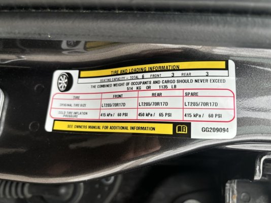

My ‘16 laramie power wagon has only a 1135 lb payload. My ‘26 big horn half ton has a 1467 lb payload. Dosnt bother me a bit. I didnt buy the power wagon to tow/haul heavy. It drags my 8000 pound camper around just fine. Honestly, im sure it does it way better than the half ton would, but dont know because i never hooked a trailer to it.
