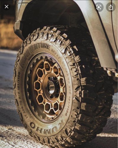

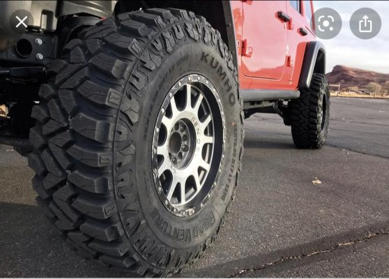

But im going to these next in a load range F
https://tiresize.com/tires/Kumho/Road-Venture-MT71-35X12.50R18.htm
There are also a few all-terrain tires that are load range F in the size if you do not want an MT
