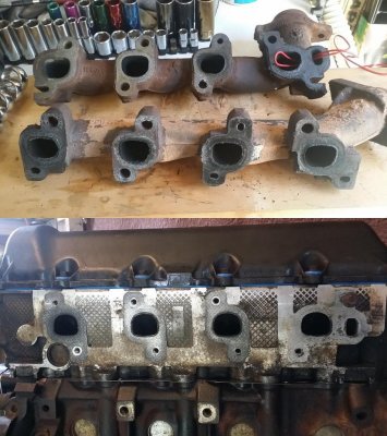

Here's a pic of the manifolds and the replaced head. I have the original manifold that goes with the head but it would be much easier to use the manifold that went with the trashed head. The port in the head seems dead ended. I'm sure it's a vent of some sort and may be dead ended because of the head gasket.
Anyone have info on what the port is for.
Thank you!

Use the non egr manifold? I mean your engine probly doesn't have the egr anyways. If you just block the hole it won't get feed anyways so you'd be fine. If your in a non emissions place just block it if a code comes up get the tuner to block it for Ya. I hate egr, just making the hemi suck it's own farts and lose power.

Yes, I'll do that: block it off and use the non-egr manifold. I'll post if any issues come up.

Update: blocked the extra hole and all is good. Thank you for the replies
