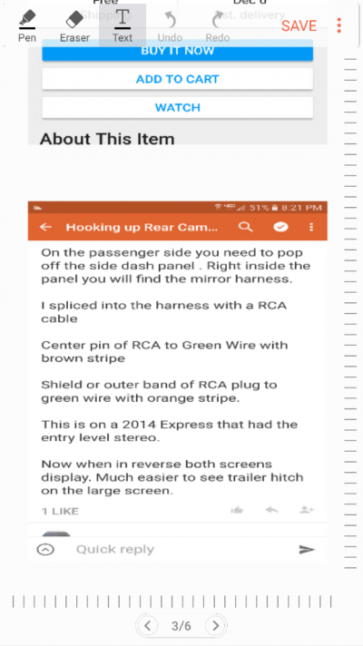

I just installed a pioneer avhx5800bh $287 on Amazon, best mod I've done. I had factory cam show in my mirror, now I have it on head unit and mirror. You have to use a video cable and tap into wires behind dash panel on passengers side. Install was fairly easy with a metra dash kit and harness. I got the avhx5800 for the HD Radio and front camera ability. 3c5e818ad649f58a1e454a7453541032.png
