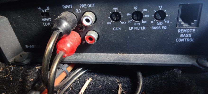

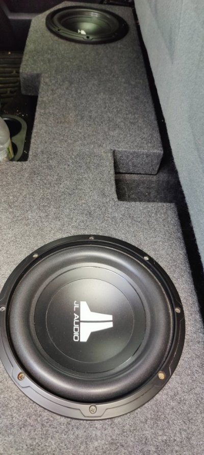

No I do not have the steering wheel controls, I suppose I should have also stated a previous owner put in and aftermarket amp, and subs. I do not know what they did. However I would guess they used a box to convert the rear door speakers to low rca and also since I am thinking about it I have in alfaobd enabled AMP 2 settings cabin and Audio/Telemat and the result of that is no sound output from the radio, go back in and disable amp and sound comes back. Not sure that is even relevant but thought I would give that extra detail.
Yeah, don't worry about that. Also, it's best to only make known good changes in AlfaOBD. Some settings are global configs that will change multiple variables that can be very hard to track down.
Ok without steering wheel controls it's a little harder to get a basic working 8.4 setup. You will have to upgrade the HVAC bezel which has the integrated audio controls instead of using your current bezel without audio controls. So essentially, there is no cheaper semi working setup you could do other than waiting to get the new USB hub and adapter as a last step (which will leave Android Auto and CarPlay non-functional until the upgrade is complete.

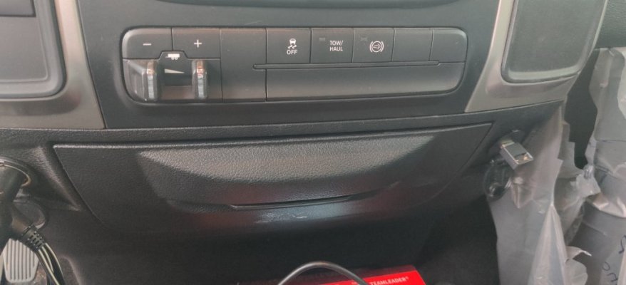

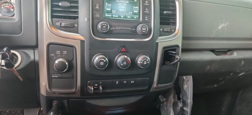

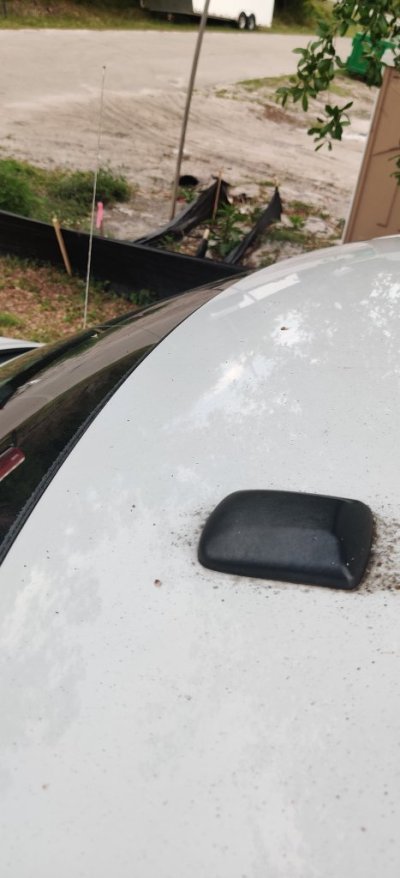

So this is the inside of my truck right now. and Is that an antenna on top, or just a placeholder? I have the wire whip antenna on the passenger fender. in alfaobd my antenna is listed as passive primary no secondary.
That's an antenna. It feeds your SXM radio and GPS functions on the radio. When you look at the back of the radio if you upgrade, both of those connections come in over the mustard colored fakra connector (plug).

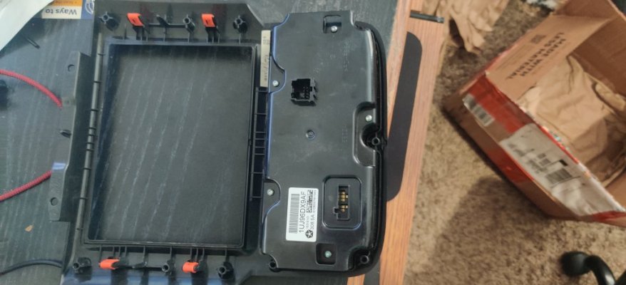

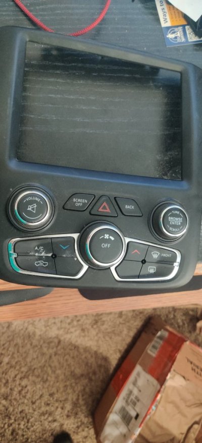

So I am going to be working on upgrading, I will need to do it slow over a long while though, however I got the first piece, and for a great price. now to verify this is what I actually need, I think so. and of course will need others.
Looking good so far!
