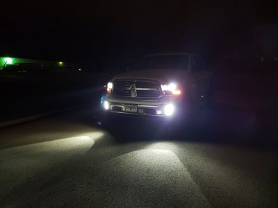

Either they were wrong before or they're wrong now. There's some pride in doing things properly.
Well, now I can actually see more than 10 feet in front of me, and they are not blinding oncoming traffic, so all is well.
