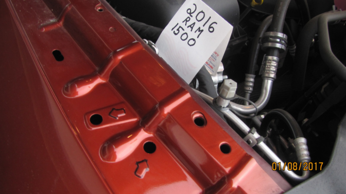

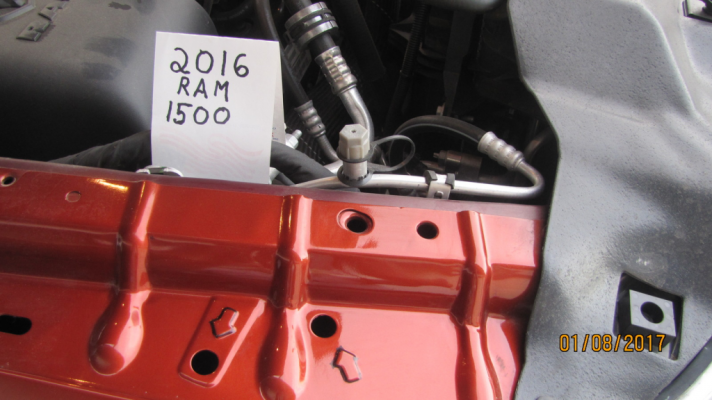

First watch this
Now find a flat section of driveway with a wall
Open you hood & there should be 2 holes with Arrow(s)

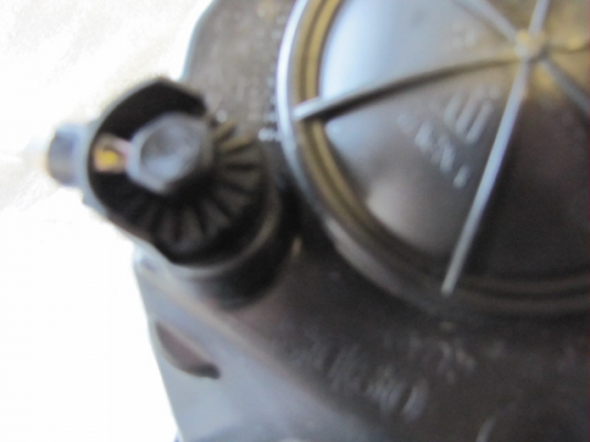

Use a mini flashlight to see which hole has the adjuster in it
you saw how the Ram adjuster works in that video
The adjuster is sensitive, so don't turn it hard
