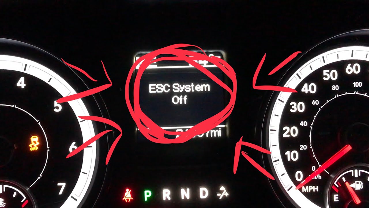

With the 4WD Lock engaged, holding the ESC button for 5-10 seconds should produce a chime, then the EVIC will display ESC system off.
It is possible that the option is not available on your truck.
