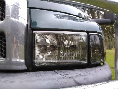

I never could find a good set of after market headlights for these trucks. I bought a cheap pair of stock looking headlights off ebay, but the side markers come loose at times. I'm going to try some from LMC truck in the summer.

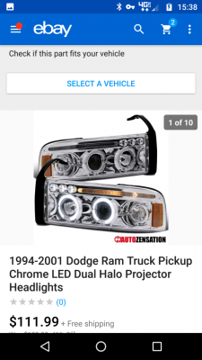

They were top of the line but I adding a lot of rgb stuff. The things I remember (all from retro fit source) was RGB projector with the flap for high beams, RGB tube, switchback inner and outer halo, RGB shroud, and accent lighting. I wanted to do this over a year ago. I was doing this on a 4 bulb system but scrapped it. Here is the lights I bought from eBay though
