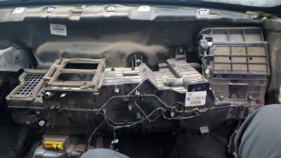

Follow up. Out of sheer desperation I took a rotozip to the plastic in front of my mode 1 and 2 doors. The white nylon nobs that are suppose to attach to the mode doors would spin around and around. I drilled a 1/8th hole in the center of those white nobs then screwed them to the doors inside the air box with 1 1/4" drywall screws. I could then open and close the doors---could hear them working. After plugging in the mode and fan switches, I moved the motors to where they seemed correct for each flow of air then put the motors back in place. Floor door closed for defrost, defrost door closed for the floor. Now I have floor heat, defroster, vent and AC on both sides. I know this isn't a permanent repair, but it works for now. There is still plastic parts to replace so the cut away plastic will not be seen. Guess I will remove the dash properly in the spring if I decide to keep this truck.
