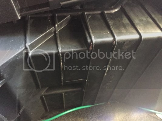

Well I noticed my passenger side carpet was wet, now it rained here the past two days so I am going check the door weather **** first because that's a common thing, BUT when I was under the dash looking around I saw coolant, not a lot a little drop but in two spots. With a flashlight I tried looking up from there and saw nothing. I'll get pictures where it's at, but is this the heater core again?! I had it replaced 2-3 years ago and now this happens again?!!!

Yea I can get a pic exactly where it is, didn't wipe it up yet so I can get pic. There are no puddles, yes that carpet on that side is wet but when I smelt it, it didn't smell sweet like coolant, then when taking panel off I see the weather panel behind door is issue, butyl tape pulled away and wasn't much there. I'll get a picture up in couple mins

You can see in pic where the coolant now dried up, that's were I notice a small amount of coolant. As mentioned above, when I look up with flashlight I see no coolant coming down from anything. Where this was spotted is passenger side all the way to left basically by the center dash.

The guy pulled the whole box? The only real possibility that I could think of is a bad part or he didn't know what he was doing and broke your new part.

If he's a Dodge mechanic and spent a whole day working on it then I would think that it's done right. It took me 2 days for mine because I pulled off more than I needed to, the heater hoses will not make it leak inside the cab. OEM is the only way to go on that stuff, I've seen to many failures of the "parts house" ones to trust it. I honestly don't see that part being a dud like that unless it got boogered up during install and created a fracture or a pinhole somewhere.
You said you don't smell the Antifreeze smell?? Did your floor become wet over night or does it start dripping when you turn the HVAC system on? Another possibility is that when he pulled it apart the drain got plugged up. The foam that goes on both sides of the blend/mode doors is notorious for flaking off and going everywhere ( I have pieces fly out the vent's at me from time to time).
Edit: I just read your original post and saw that you had it replaced 3 years ago... I was under the impression that it was JUST replaced. I'm leaning more to the plugged drain theory, but as stated about it's not uncommon for one to crap out like that - but it's also unlikely given that the OEM is higher quality and will last longer than 3 years when installed properly.
