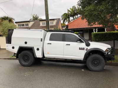

With the beast now completed - there is heaps of weight added to the back and a fair bit past the rear axle and the centre of Gravity much higher - can anyone recommend a heavy duty rear sway bar - the bigger the better - thanksIMG_3449.jpg

Hellwig, part number 7306. Its a 1 5/16" diameter (33.33mm) solid, heat treated chromoly monster. I think it will work pretty good for your application.
