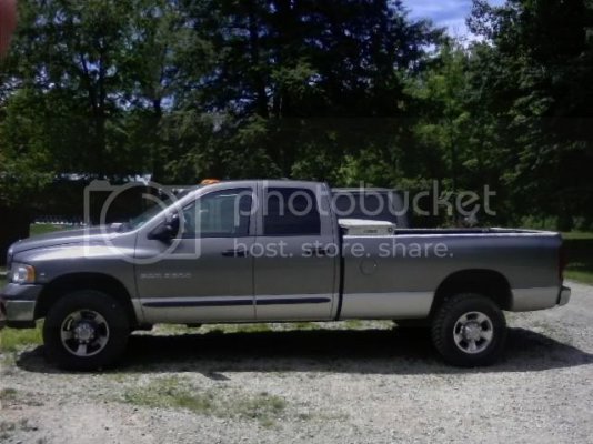

Stock with 285/75/17

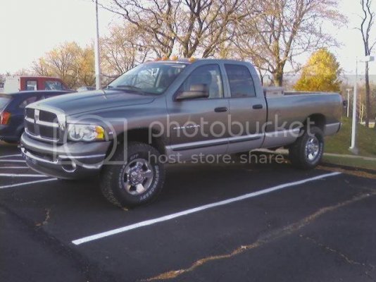

Stock with 35x12.5x17
2" HBS with 35x12.5x17

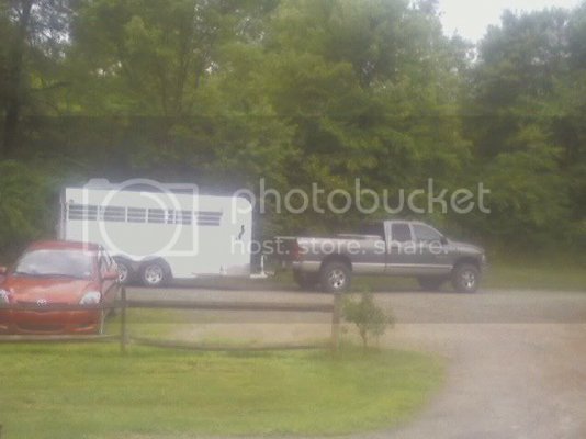

procomp es9000 on all 4 corners and just over 6k lbs trailer weight
