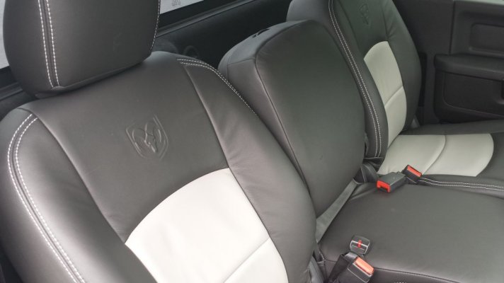

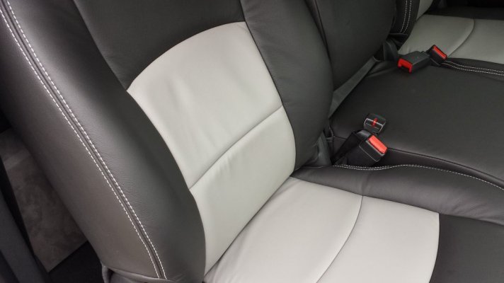

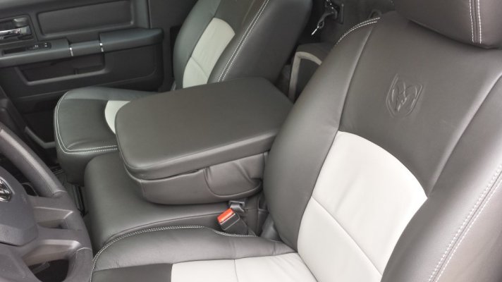

I had mine covered in Katzkin, made a world of difference.
