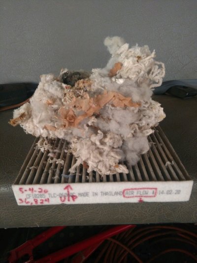

It would reduce air-flow….which MAY increase the temp of the air exiting the core…but not be helpful if the cabin is suffering from low air flow. (Behave similar to having the fan-speed set Low.)
Why Do you suspect your core air-flow is blocked? Do you have a cabin air filter ? Have you replaced it recently?
Here’s a pic of what I found when I changed my wifes cabin-air filter. (mice/rodents love to seek a cozy spot to nest
I have lots of air..Just no heat
