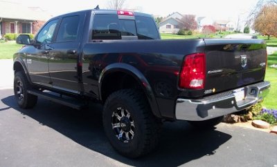

Here is mine with a RC 6" lift and 37" Toyo R/T's
Needed spacers with -18 wheels ,but no rubbing at all with zero trimming
They sold me the Toyos for $ 1,256.00
turns out roughly around 5'2" to the top of the tail gate and 7'4" to the top of roof

What size spacers did you have put in. I'm wondering if a -24 offset you would still need

Truck looks great!!
