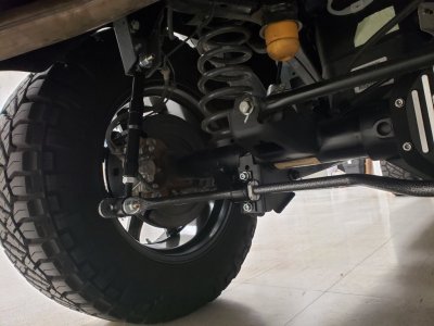

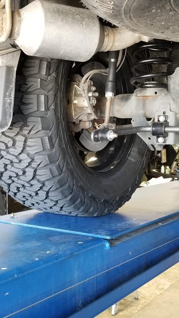

Interesting, I also installed the 7883 kit but my links are different. I have much more thread exposed. I'm not lifted only running 1.5" Icon Rear coils. Not sure why the difference. Different kits for different lift amount I suspect, as they have several versions of links depending on lift amount.
My Maxtrac lift has a bracket that moved it down, let me see if I can find a pic. The upper bracket.

I assume I will need the bent panhard bar for diff cover.
Stock one barely rubs it now.
JB1
Nov 3, 2011
8,366
7,542
Houston, Texas
Yes get the bent bar since your relocation bracket is from the frame and drops the bar down. My relocation bracket is on the diff so it’s raised up therefore I got the straight bar.
Don’t forget code “hot damn” gets you 5% off but I think Nick can get them for you too.
