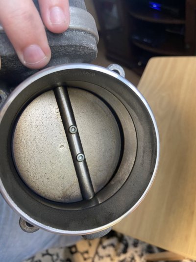

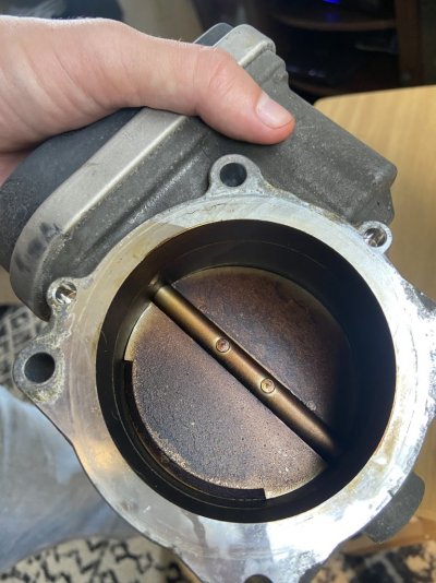

A brief update:
Picked up a can of cleaner, took off the throttle body and cleaned it.
It’s back together now and the check engine light hasn’t come back on yet. I feel like it still might so I’ll get around to resetting the code and see how it rides the days following.
For now, it drives fine. Just went a couple miles down the road with it.
Before photos are attached. Didn’t take after photos. Plate and bore look back to new.

You did a great job. Let us know after driving it a few days or a week, if that resolved the problem. If so, you saved a bunch of money.
