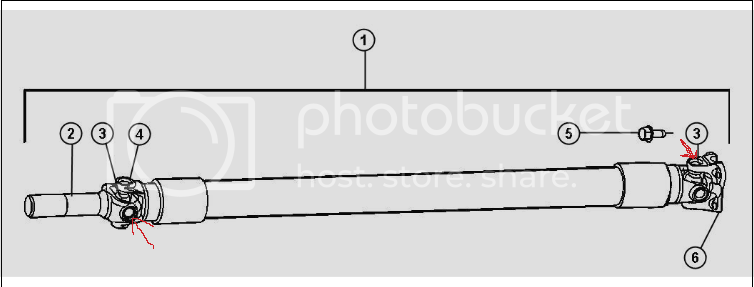

Ok, got a good look at my truck this afternoon, and this is what appears to have happend.
at the front Yoke, were the u-joint connects, is where the failure happened. The lip holding the u-joint in place broke, causing the shaft to spin wildly and breaking the other lip. At this point the shaft fell to the ground acting like a pole vault. Luckily when this happened I was turning into the parking lot at a slow speed (5mph) and the shaft twisted at the rear u-joint, and only snapping the u shaped U-joint connector at the rear flange. This is when the shaft fell to the ground.
I’m currently looking at replacement parts. I need to replace the front Yoke, and the rear flange.
I also found the part numbers for each - Flange - 5015556aa Yoke - 5014043aa
At this point I'm just looking to see if anyone knows were I can obtain these parts at a decent price. Thanks!
