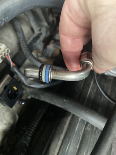

Hello everyone. So months back I thought I was having an issue with my fuel pump. Turned out to be a wiring connector…so I pulled the quick connect clip at the fuel rail to test for fuel. Anyway…I don’t drive this much and a month ago I saw it leaking, pulled it out and the o ring was distorted…put a new one on and it seemed to be resolved. It’s now cold out and I noticed it leaking again but nowhere near as before. Question being, what else is supposed to be in the port other than an o ring and what looks to be like a small nylon washer. When I unhooked it the first time it’s possible something else fell out. Thanks!

I would post this in the 2nd Gen thread. Most of us that look in the 1st Gen section wouldn't know.
