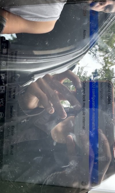

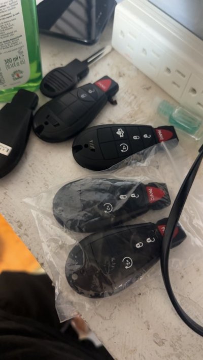

Car Electrician says so. He jumped starter it works however look at the scan tool. I don’t have rke functions also. This is after switching out Tipm but that’s not the issue. As I’ve used that tipm before in winter and just got u codes.I put the old one back. it was Alpha obd I believe I fried something messing with WCM function. I like working on my own stuff I was curious. you live and you learn however should I invent in a repair of the switch or replace it. Last photo for ***** n giggles I have 2 keys that were never programmed can I use those and can I repair the switch thru a service or should I get a new one or oem used thanks yall. And any good input I can use IMG_0740.jpeg
