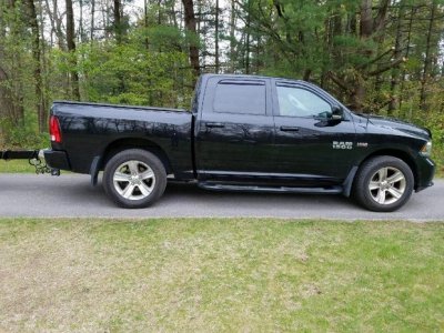

I have a 2014 RAM 1500 Sport. I believe it is the max tow setup for this model. Around 10,300 lbs with the 3.9 gears, short bed, etc.
I am towing a very large boat. It is all of 9000 lbs with the trailer. I just hate how it squats (see pics). My setup is basically stock. 66k miles.
What should I do? Lift kit and bigger tires? Level it? I don't want to go too big. This is my daily driver. I just want to feel a little safer towing.
One question I had is I also bought a Gen-Y hitch and it sticks out quite a bit more and probably shoves the tongue weight back a few inches. Would this make it squat more? Thanks in advance!

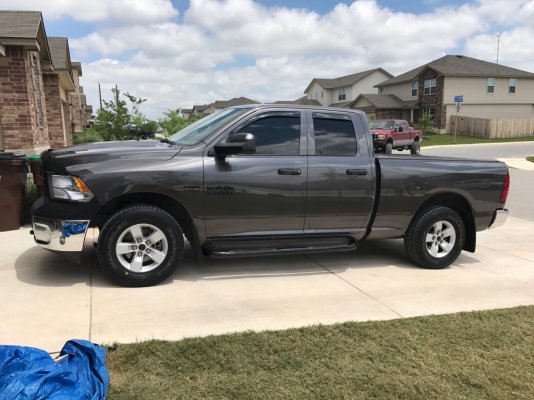

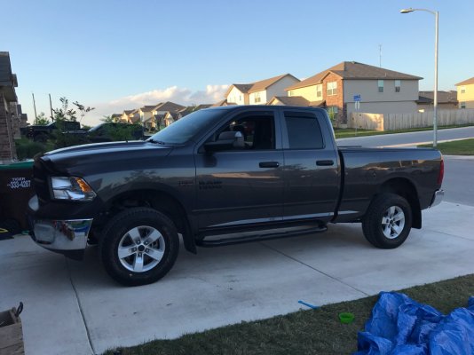

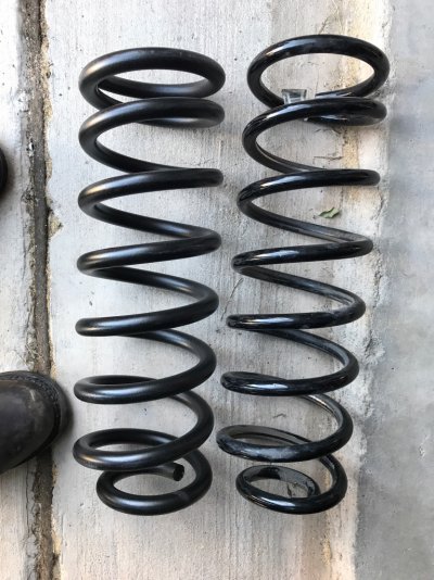

I have some TufTruck TTC-1223 Springs and with my 7600lb Camper it barely squats. I also added AirLift 1000 airbags for warm fuzzies.

Before Bils and Springs
After

So my Bils raised the front about 3.5 inches and these springs unloaded raised it about 3" in the back, so I have some rake still which is what I wanted.
It does ride a little rougher but not that I mind. It is a truck after all. Night and Day with my camper hooked up. You can just tell in the pic above that the TufTruck springs are way beefier

So the only reason that I did the bils was because this springs will raise the back of your truck 2-4" only because they are stiffer. I didn't lift it, I changed the springs to benefit my towing.
