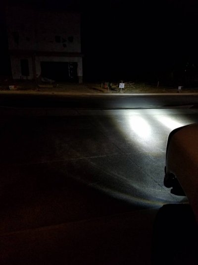

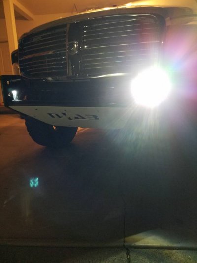

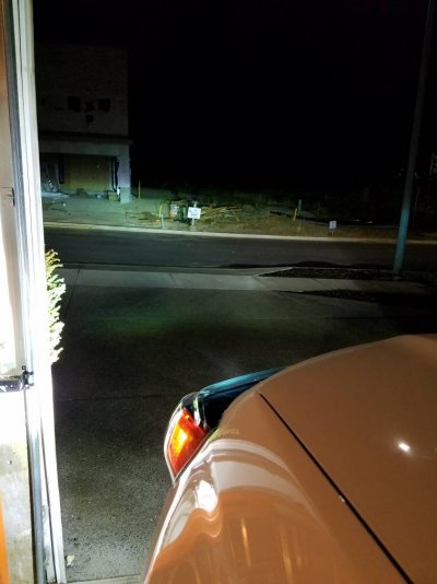

Ok so these are terrible pictures but I'm just opening my garage doors and turning the lights on so you can see the output. I didn't think about it before but my Dually spots are kinda a bad example simply because I have mine pointed pretty much directly down in front of my truck. I do extreme enduro riding so all the places I ride are DEEP in the woods and the "roads" to get there are all deep rutted out trails that have tree stumps and logs everywhere and a lot of times I end up leaving at night so, I have em pointed like that so I have crystal clear view of in front of my tires basically. But I suppose you can kinda still see how bright they are and id imagine the floods are just as bright. Second pics are of no lights on vs 35W HID's in projectors out of my girls 4runner, which you can do to your headlights for fairly cheap, retroshop.us has many great lighting options. again bad pics kuz of street lights and my garage slopes downhill a bit so her lights are aimed more at the street as opposed to out, believe me on a dark backroad the 4runner turns night into day, so do my spots but like I said I have a specific thing I use them for so mine are pointed way down. I'm in the process of retrofitting projectors into my headlights now kuz the lighting is great f36b4b115681927b34255b2218093ccb.jpg285e9cdeadb8b8b78ea26664c0c91c77.jpgd070bc2010c464ceee2f0ac4f9ec6877.jpg1b4b4ea694a80d05378dc5afb5371c6f.jpg
