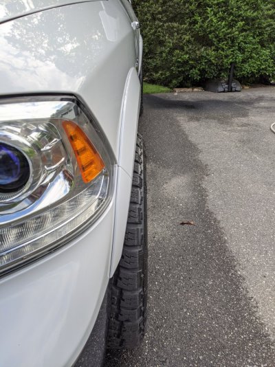

Heres how she looks now

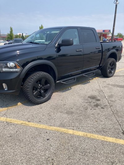

Thank you. I also have stock flares, but I am going to switch to the rivet style. Which are 1” wider.. I want to have the tires close to flush with the wider flares.

You may wanna look into a 20x10 wheel then, anything from -12 to -25 would do
