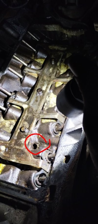

Someone please help me understand if these holes are supposed to be here or not there's one in the opposite side in the back

Techinical term for them on older V8's like yours are "Oil Drain Back Holes".if you lift the spider cage holding the lifters in place,you should find bigger ones that will let you actually see the camshaft.
