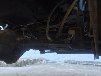

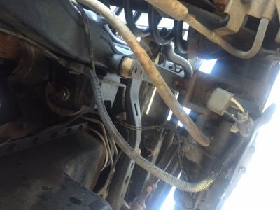

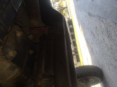

Check this area in the pics the red and black lines. Could also be your vacuum switch but check here first.

Yea those are all the lines i checked and the front drive shaft is locking in 4wd but still no idicator light illuminating and just back tires spinning
