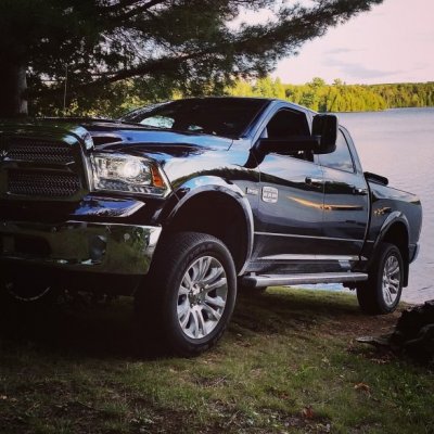

Umm..well you can't stack a level with anything else so I'm not sure how you're planning to do that? Some guys go as far as a 3" front level but that's pushing it. How were you going to lift 3" in the rear? Bigger coils? You could fit 35's with just a 2" leveling kit.
Everyone wants a suspention lift done inexpensively but unfortunately it's not something that can be done lol.
What I'd suggest for you would be a 2" front level, 1.5" rear coil spacer, and 1.5" body lift. That will give you the 3" lift you are looking for and shouldn't be too hard on your wallet! I did that but with a 3" body lift (kit costs $200 more, same install price as 1.5) for $1700 installed in Canada.
