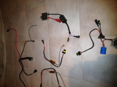

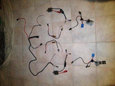

confused
never installed a kit like this can anyone give guidence, its the night vision headlight kit. hope the pics post. photo.jpg
Bigdaddy
Dec 13, 2011
2,422
486
2022 3500 Laramie CCLB
6.7L Diesel Cummins
What I did is to start with that top one, the one that you have to hook up to your battery. Run the long tail end over to the passenger side headlight. Take out each headlight form your housing and install your hid bulbs in the headlights and the rest should come easy. The ballast go to each of the headlight wires so just take your time to install them and you should be good to go.Hope that help.

So i dont use the extra jumpers?
05singlecabHEMI
Jan 26, 2011
2,692
99
Lilburn,GA
2005
I made this video a while ago, it might help
player.swf
A
AKreed22
May 21, 2011
29
AZ
2005
4.7 v8
05singlecabhemi got me straightened away, appriciate the time and effort to help out bro!
