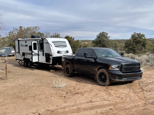

This is the trailer I pull it’s a 2306bh advertised at 46xx lbs and it’s never been under 5000 even empty.
I’ll tell you that my truck doesn’t like towing it in the hills. Oil temps get up to 250° if I don’t back off and I end up going <=50mph to keep it happy.
0 issue with power, braking or being within numbers, but I sure wouldn’t want anything heavier / longer.

I assume that’s a 23 ‘ living space based on its number? Does it have a slide out on the other side can’t tell from the pic? Truck is a Hemi with 3.21 and 8 speed as well?
That's another crux of the RV industry - the numerical numbers in the model number don't REALLY line up with anything anymore. They used to, and some manufacturers try to hold to it, but by and large they don't. For instance, we have a Shadow Cruiser 277BHS. Its interior living space is 32 feet long. The BHS portion does tell you that it's a bunkhouse (BH) with a slide (S).
23’ “living space” yes, closer ~30’ end to end
Does have a slide
