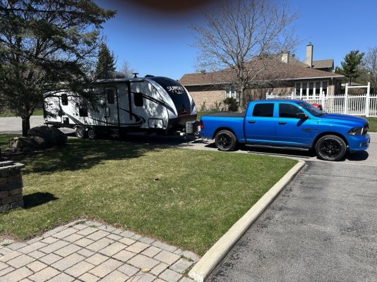

Chiming back in from last winter to say I have the trailer and have it hooked up. I did a trip about a week ago that was around 200 miles round trip. Everything went well. The truck pulled it without any drama and all temperature readings looked very good. The oil temp went up to about 225F but I feel this is expected with the engine working harder than empty and doesn't concern me. Otherwise temps didn't move. Gas mileage was respectable in my view about 12.7 mpg at 55 mph. Obligatory pick of my setup with WDH.
