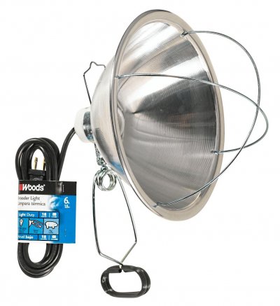

Heat Lamps are a great source of controlled heat
I use this kind of fixture for working under the hood of a vehicle, just switch the type of bulbs
