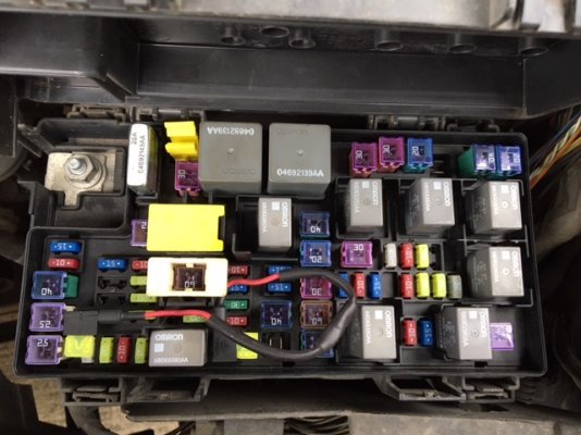

Also, found a jumper wire in the fuse box--is this normal?

That jumper wire may be because of an issue in the tipm. It's fuel pump relay may be bad. Have you changed the battery yet? Or checked its voltage? That would cause issues you are seeing now.

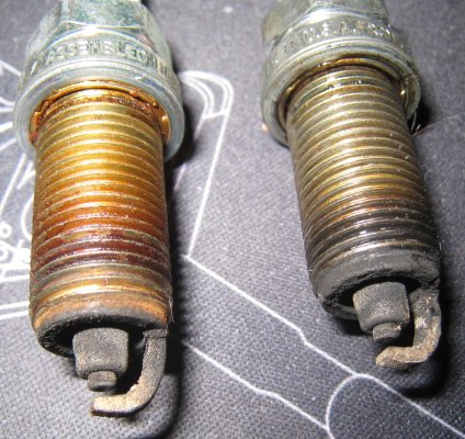

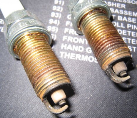

Today, I swapped the plugs from cylinder #1 (first pic) with cylinder #3 (second pic). I'm no expert at reading plugs, but the plugs from cylinder #1 look fouled. Also, one of the plugs had a gap of close to .060"! The other three were between .050" and .055". They were re-gapped then reinstalled.
No new codes, but Cyl #2 misfire (P0302) is pending. As before, still getting permanent misfire codes of P0300, P0301, & P0302. As understand, those codes won't clear until the problem has been fixed.
I would hate to have the owner buy new plugs, when I'm not 100$ sure it will cure the problems.

Did you swap the coil packs too. If so, Try swapping the fuel injectors between those cylinders. Those plugs look fouled.

Those plugs look shot in my opinion id changed them i know it has pending codes but do you clearly feel a dead miss? also its easy to pop the valve cover and see if the valves move when you crank it over will tell you if cam is shot.

Valves not opening/closing all the way will foul plugs.
