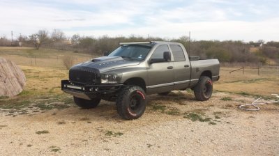

Okay I need some opinions. Now I currently drive an 07 lifted 2wd with a 4.7L that has damn near 200,000 miles on the motor. Most of you don't know this but my family owns a salvage yard. In the yard currently I have a 94 12 valve cummins that has everything there the truck was just hit real hard in the ass. I also have an 05 hemi hit the same way so everything is also there. I am going to transplant one of these drive trains into my truck.
Before you tell me to go out and just buy one dont, I don't do things that way. I like to build everything I have myself.
So which would you do? The hemi would be easiest and I could probably do everything in a weekend. Everything would line up and bolt right up, same ac setup and everything else. The cummins is also doable, I've seen it done. However, I would have to transplant fuel tank and pump as well as a few other things. Not to mention probably reinforce the frame a bit and build new motor mounts.
If I want my truck back quickly, I could do the hemi, which would be nice to have. The cummins though I think would be bad freakin ass. It would really make this truck one of a kind. My gut says hemi but my heart says cummins...
I need some input. All opinions welcome. Couple pics of my truck for fun...
