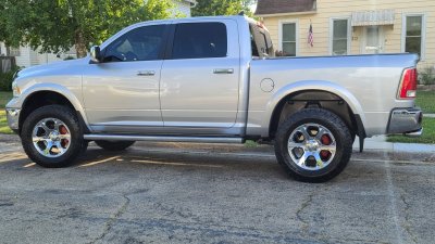

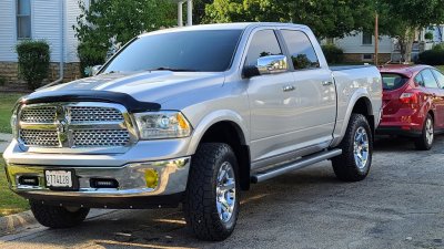

You won't fit the 12.50 on there without a spacer otherwise you'll rub the arm. I just put OC AT3s on mine, tallest you can go without rub would be the 295/65/20 - that's where I'm at. This tire is 12" on the dot on a 9" wide rim.
For reference - I'm actually a tad taller than where you will be. I'm running eibach spring w/ 5100 at 3rd notch and a zone 1.5" body lift in the front and a 1.5" coil spring spacer and 5100s in the rear.

@regal81455 appreciate the info - one question do the 295's sit flush with the outside of the wheel well? I don't want the wheels sticking way out past the wheel well. Wheel spacers are an option I would consider Bora wheel spacers if I go that route with the 35's

I don't have a down the fender pic but they're basically flush with the oem flares. I can get one later today if you want me too?
