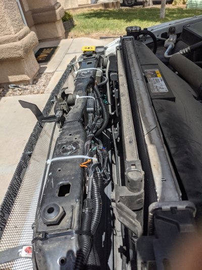

I mounted some on the frame behind the headlights and some on the front cross support in front of radiator. Plastic piece covers it up and easy to access.d21fb36bdd4b5cd5557f4503b8ed1ce3.jpg
