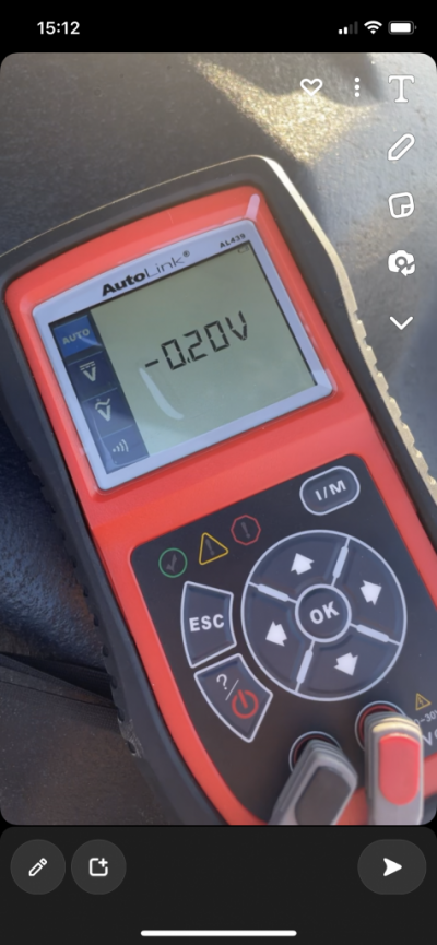

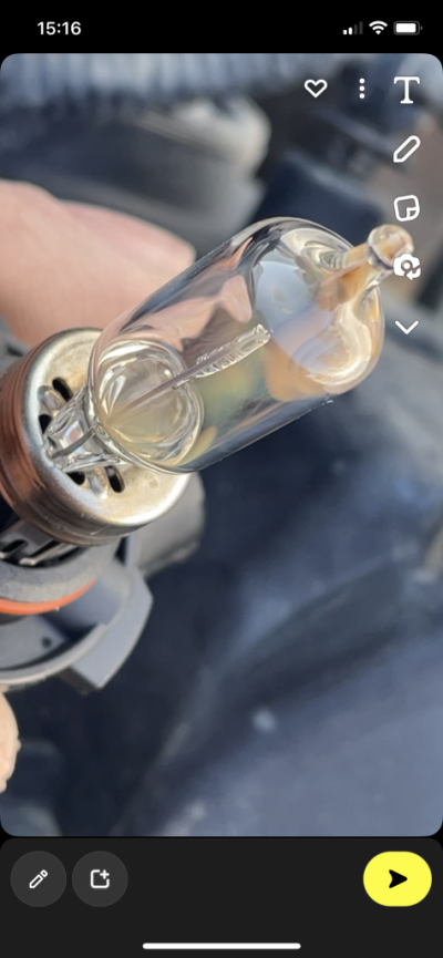

So, I pulled the headlamp assembly out and took a look at both bulbs (there was a little brown discoloration in both *see picture*). Next thing I did was take my multi meter (with the truck in manual mode and high beam lever pushed forward) I checked the connection…-0.20V or something like that (also shown in a picture).
The low beams were getting a solid 13.45V so I assumed i should be getting a similar amount to my high beams. For kicks and giggles I popped two LED ones in from the local automotive store, still no high beams and still no indicator light in dash, so I took the lights back. The only conclusion I seem to come to is that there is a bad fuse, a bad relay, or an issue with the “multifunction lever”. The last one doesn’t make too much sense to me since, my wipers and signal lights work fine and haven’t had any issues with those. The fuses all look good from what I can tell. And I even pushed them all to see if they were seated correctly (understand that i only looked at the fuse box under the hood as I can’t seem to find one under the steering column). Which leaves a relay, but according to my fuse box lid, I don’t have a relay that deals with high beams or headlamps in general… maybe a bad BCM (body control module) or TIPM (I think that’s what it’s called)?

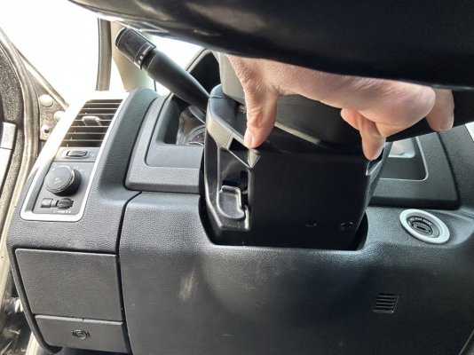

Just in case anyone is wondering what the actual issue was, it was simply the multi-function stalk. It was a really easy replacement and I got an off-brand one from RockAuto and it solved the issue right away. I now have the ability to use my High Beams, turn signals, and wiper functions! Thank you to all of you that gave me some advice and help while I tried to figure out what was wrong. It was a really easy process.

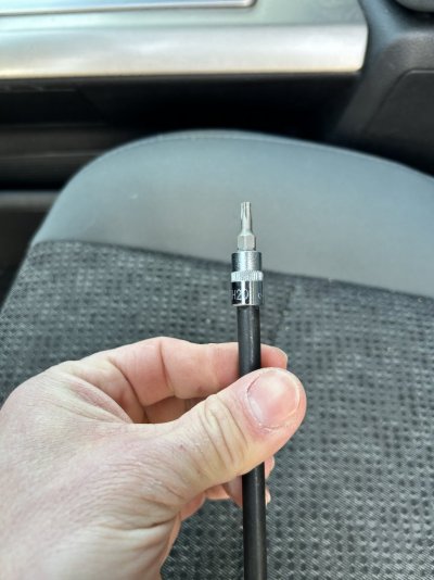

Tools Needed:
T20 Bit
Screwdriver or Ratchet
6” to 10” extension
The Process: Take the two inch and half screws out of the two recessed holes on the bottom of the steering wheel, once they are out you can pop off the top portion behind the wheel to gain access to the multi-function stalk. Once access has been achieved simply disconnect the wire harness to the back of the pre-existing (one with issues) multi-function stalk. After the wire harness has been disconnect there is a little clip that is closer to the steering wheel that needs to be depressed and the Multi-Function stalk will release and you can pull it out. Installation is simple, with the new part, simply slide it into place and when you hear a click you’ll know it has been secured. Re-attach wire harness, put cover back on, and re-insert the screws and you will be all done.
If you have need to perform this job, hopefully my description and the attached pictures will assist you in doing this as well!
Again thanks to the community for the assistance I received!
