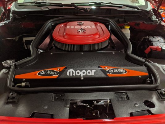

I have the Vararam, I'm not going to claim the hype of better MPG or HP. I bought it for the old school looks and the old school looks only. My truck runs completely stock at 14.1 second 1/4 mile so don't know if the Vararam helped or not but it looks great and sounds great!
Nice! It definitely looks old school.
