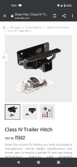

I wonder if he has something like this from the factory. I know this is a Curt but it mounts the same as the factory one. Two bolts through the rear cross member and one up through the hitch ball hole in the bumper. (Image and explanation borrowed from another thread)

That it the pic i posted in another thread, and my description. Lol
But that very hitch is rated class III / IV. I personally have the drawtite version of this hitch as it looked to have beter welds than curt, also a better, more percise fit, and larger hardware. The saftey chain holes are a bit larger on the draw tite also.
Here is a quick pic of the drawtite one. d6349972c0b4d134148bb188edde8604.jpg
