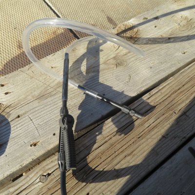

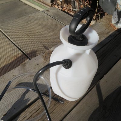

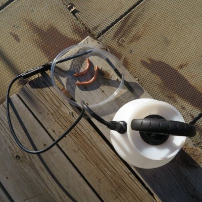

This is my version of a weed sprayer transfer pump.Most video's showing how to build one go a bit crazy with adding a ball valve.I just re-used the trigger shut off valve,and i made up a couple differant brass ends to fit differant applications.I just remove the straight end,and install one of the brass ends as needed,or just use the clear vinyl hose as a last resort.

That's about all I did. I cut the nozzle off of the end of the wand. The OEM trigger valve seems to work well enough.

I built mine back when i had to replace the 8 speed in my truck,and that's just over 6 years ago,lol.I just stumbled on the pics i took of it back then today,when photobucket told me they were deleting my account,lol
I'd forgot i had a photobucket account :Big Laugh:

Tell you what,go pump a gallon of fluid into a transmission with a slippery pete,then come back and tell us how well it worked,lol. A slippery pete sucks to use when you're under a truck holding the end of it in a hole with one hand,and using the other hand to pump with,especially if you're in a hurry to get it done while the trucks running and you have a small time frame before you're past the temperature window.
Trust me,this blows a slippery pete into the weeds,and is far less messy to use,as i've yet to use a slippery pete that didn't leak all over my hands when pumping.
When you're done pumping 5 bottles into the transmission with a pete,come back and tell us how your arm feels,lol
