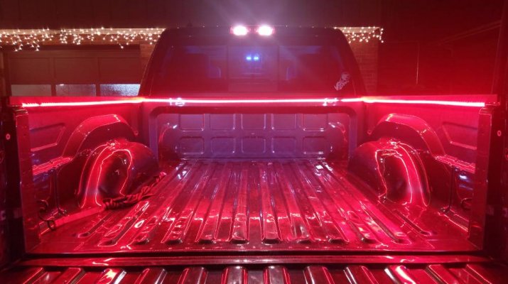

They were held on by screws and double-sided tape. I only took the passenger side light off and wired in a red LED strip. f3cf7a7d7b265303acbe8a35bc18f14d.jpg

So you tied your additional lights into the factory bed lights and have no problems? I realize that LEDs are very low current draw but some of these circuits are pretty sensitive. Just wondering if that much added could be an issue.
On a side note, when I was scouting drain locations for my tonneau cover I looked up into the stake pockets from underneath and noticed the connectors for the bed lights. I did not note at that time whether I could have reached them to disconnect them from below. If so, it may be possible to make connections without removing the lights from the bed.

I haven't had any issues at all. I removed the factory light and ran the wiring for the LED out from behind it.
